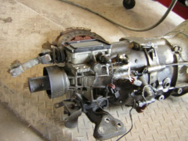

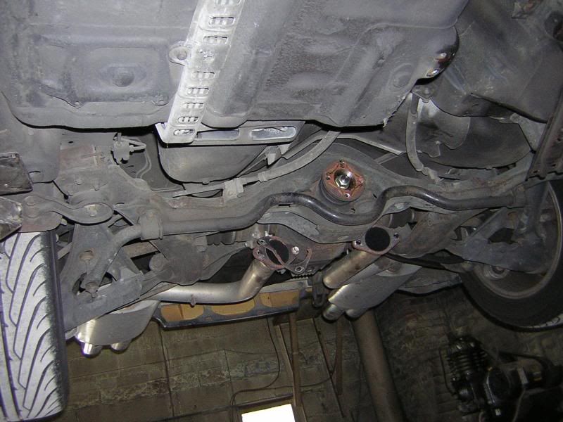

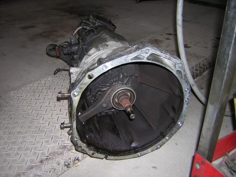

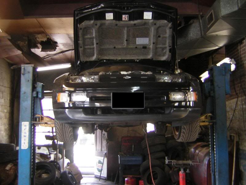

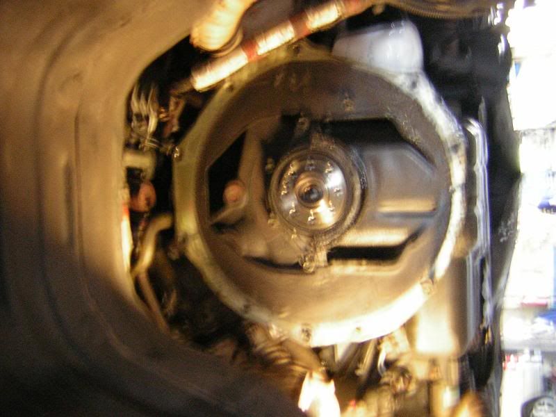

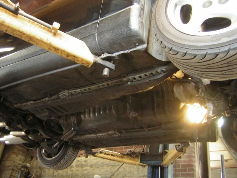

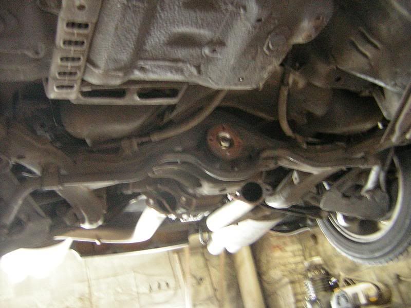

Message The clutch booster and slave cylinder was also replaced. Am using the conceptzperformance hardened pivot bolt along with new rear main seal and rear trans seal and new OEM rear motor mount for the 1-piece driveshaft.
I have not posted pics in years on tt.net but here goes, some of it is cell phone pics and the rest is digi cam. Sorry for some blurriness, but hopefully, you all get the point. I hope this will help some folks get some kinda reference of what's involved.

New clutch kit:

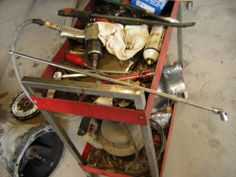

LONG extension needed for top of bell housing:

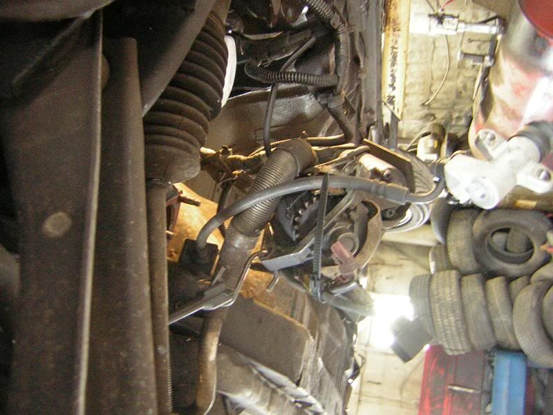

Starter:

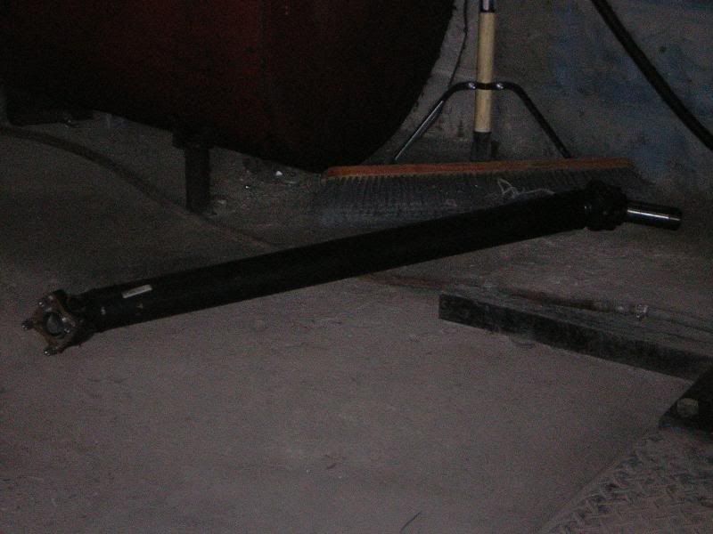

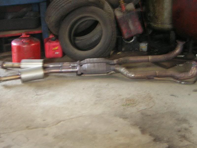

1-piece shaft:
Borlas:

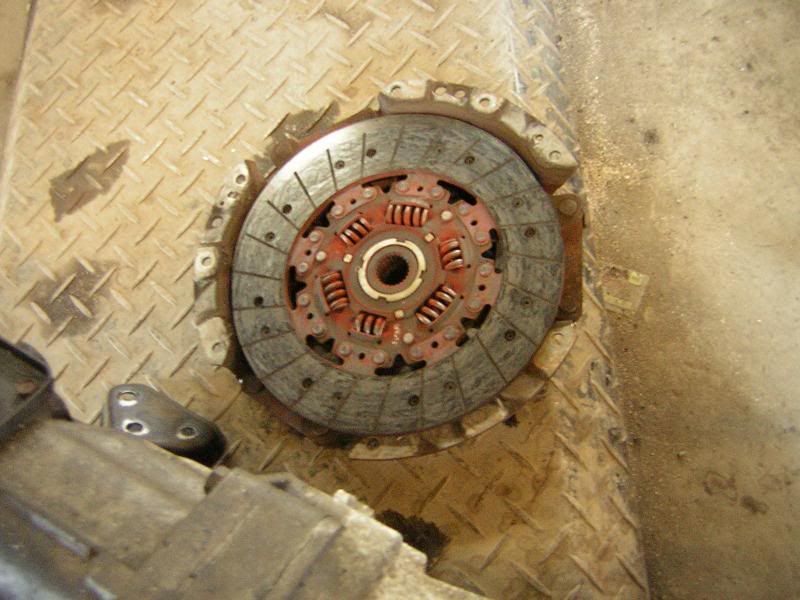

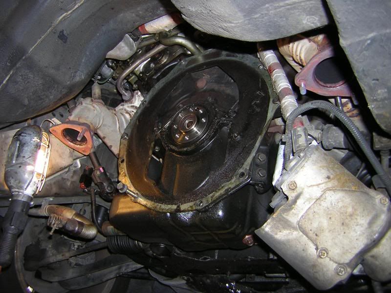

OLD clutch:
